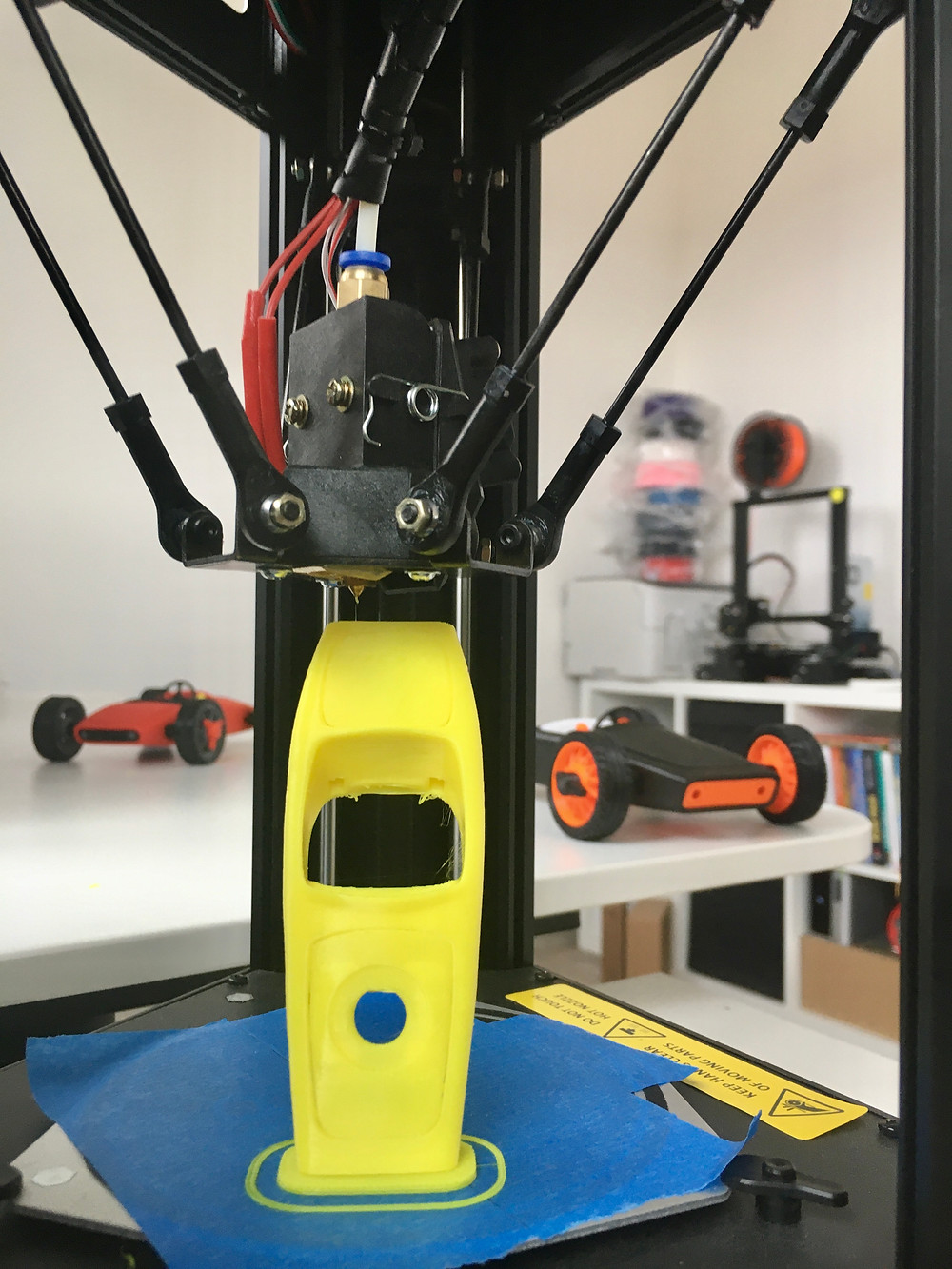

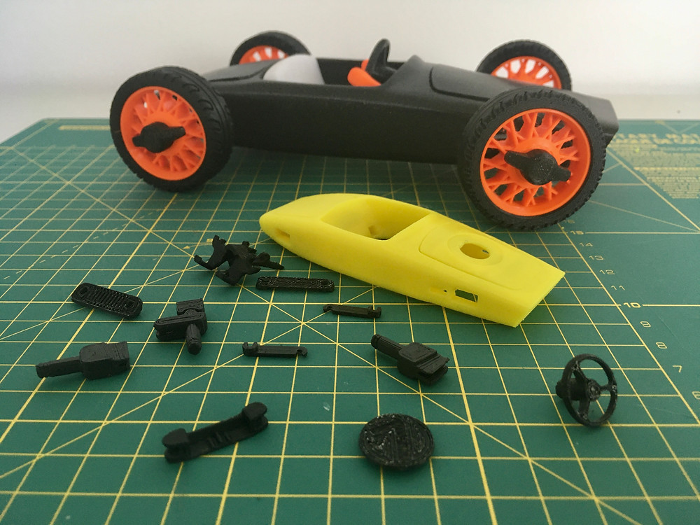

Hello guys. Iam really happy with my last printed project. I'm a fresh owner of little monoprice delta mini. After a couple of tests I decided to try small CAR-A-MEL car. Everything in 50% scale ( theoretically it would be possible to 65% scale ). Front joints was necessary to quite remodel because of sterring. The rest of parts after some postproduction, cutting and grinding work well. Only turning needs little update. Maybe later :-)
As I wrote above, Printed on really cheap Monoprice Delta Mini at 0,1mm layer height and 0,4 noozle. All files was sliced in Simplify3D. Original profile needs some little updates. Because of delta printing was necessary to set 0,5mm Zhop ( especially the body that filled almost the entire height of the printer) , quite bigger retraction distance and higher temperature. The printer sometimes has a problem keeping the temperature constant.
All filament was classic PLA and ST-PLA from Creality.
And here few photos from print and build. Enjoy !
